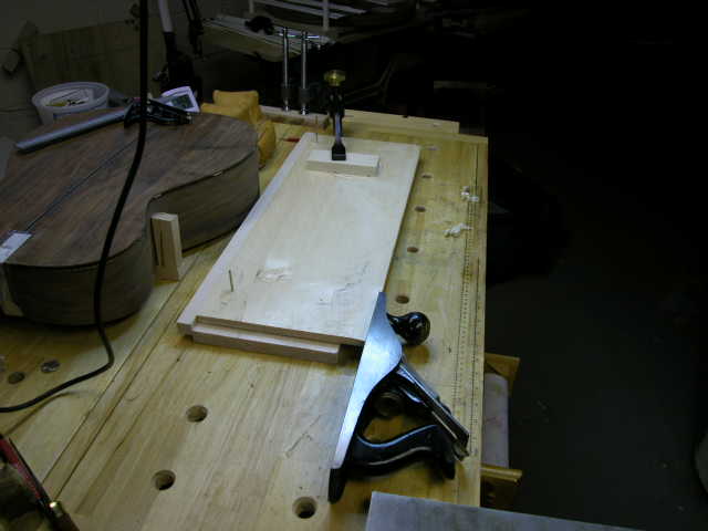

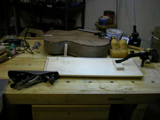

Well, I'm not sure this is that helpful-however, I did learn to convert for one whole lot of $ less than the $ estimated before.Hope the size is within the rules.Wow, my workbench is a mess.

Maybe the better perspective.
